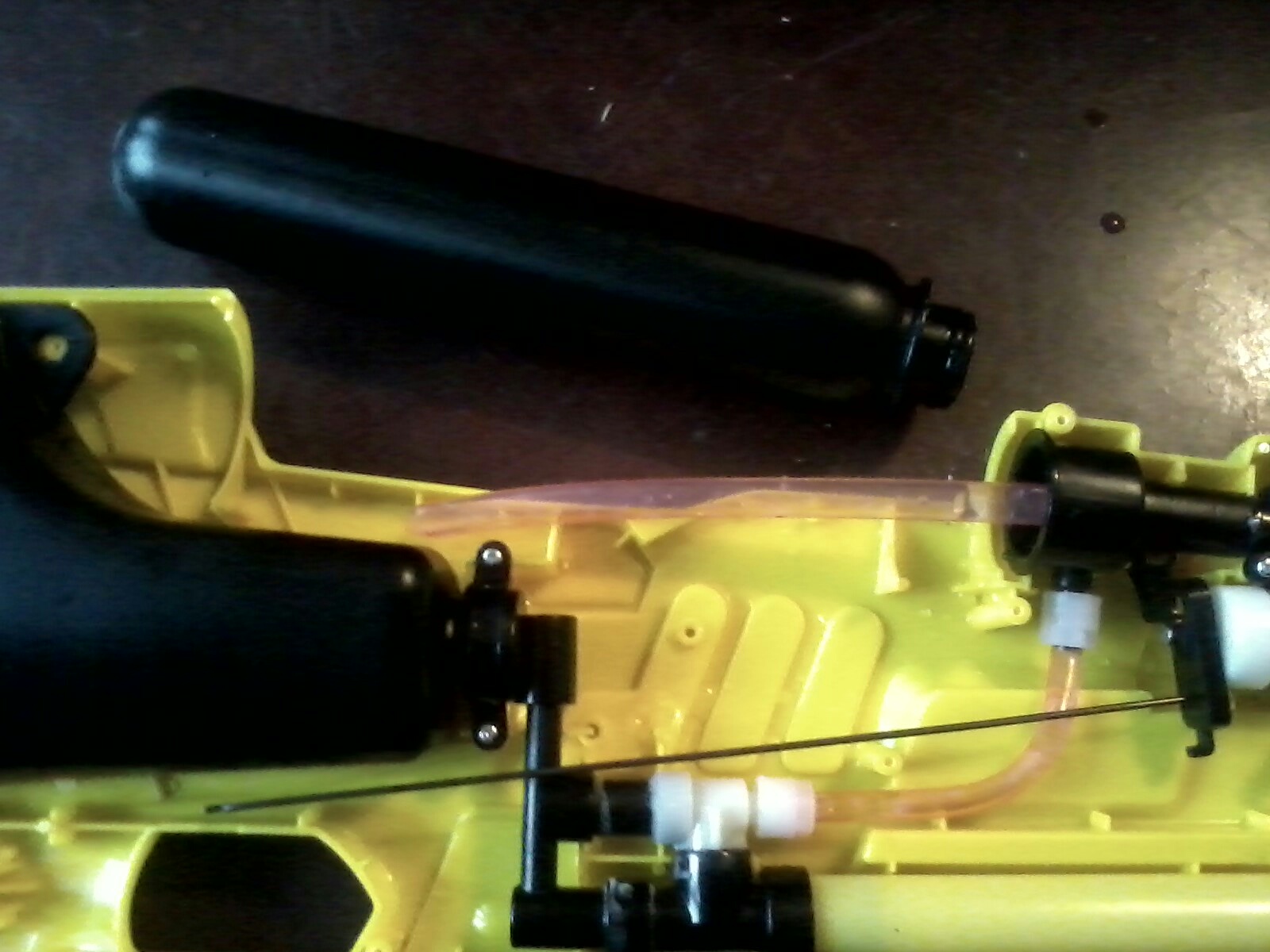

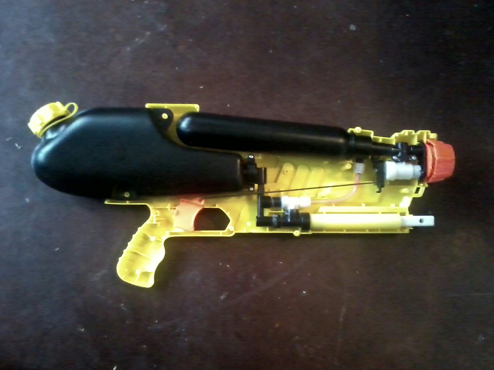

More from marauder.
Stats:
- 18.5 x 2.5 x 8.5 cm
- 4.2" pump stroke
- 15mL (0.5oz) per pump
- ~9 pumps for full pressure
- (Calculates to 135 mL PC capacity)
- 1/4" OD tubing (not sure where; might just be the pink tubing)
- Pump ID/seal OD: 15mm
- Check valves: 1/2" OD (12.7mm), connected by 8mm pipe
- Range: 38' with wind. (Expects at least 40' with no wind.)
- Nozzles: 1.8mm, quad burst. (Only 2 nozzles?)
- Reservoir capacity: 29oz (858mL)
- PC capacity: 5oz (148mL)
Edit: Described as a "better XP 70", and is smaller than the Python 2.
With this description, I have less interest in getting one other than for review purposes, but I do suppose I could make do with expanding the smaller air pressure line in my armory, with something that has a separate chamber.
Also, definitely looks like the patent mentioned earlier is not actually in use here and/or the concept holds no water. (Make what you will of that pun.)

Is there any reason for such a long small PC rather than a more normal one? Also, why bother with an intake tube for the PC? Could it be avoiding some patent, since the C2/colossus also are configured the same?
Re: Water Warriors Charger
Yeah, I get that they could have made the PC larger by increasing its height, or that they could have expanded the reservoir capacity a little into the interior. Those are minor things in my opinion. If you had one you'd see just how small it is and how these improvements, while nice, would only be minor in nature. There is very little extra space available on the interior. The reservoir/pc/pump is nearly identical to that of the Defender, but the body is a little bigger. I think that this is a good thing as it makes the gun easier to handle/pump/fire than the Defender, and let's be honest, there really isn't much extra space in there anyway.
So how does it perform? Well, that all depends on what you were expecting. DX told me via text that he was hoping for something comprable to the 150/310/270. Those are in a completely different size category. This is not a replacement for the Colossus 2, which according to the back of the box is still available in some locations. This is not even a replacement for the Python 2 - it's smaller than that, something closer to the XP 65 or maybe Outlaw. It feels truly awesome to blast a quad burst out of a gun this size. In a fight I would completely take a Charger over an XP 70, 65, 55, Defender, MS 4000, Outlaw, etc. The other nozzle is about comprable to that of the Defender or Max D 4000. It shot 38 ft with a good amount of wind. It felt impressively powerful. I am not going to say that I predict it will hit 40 ft when I retest, but I will say that it's definitely possible. Either way, it's better than everything else its size in my opinion. Taken vs the Python 2 and Python there are some definite advantages and disadvantages. The PC means you have to pump less and that you can fire at different angles, but the smaller size means you will obviously run out of water quicker. I think I may possible take it over the original Python due to handling issues, but with the ergonomic changes made with the Python 2 I'd definitely go with the P2 due to the larger capacity; but again... we are dealing with different sizes here. I remember that some of us were surprised at how large the Python actually was. Some of you may be surprised at how small the Charger is. It's not that its short, per se, but it's slim. Kind of like an SC 600 in miniature you could say.
Anyway, I think its definitely a good gun. It just feels awesome to launch a quad burst so far out of a gun this size.

Interesting. I saw this blaster, thinking it might use that patent, but it appears not. Still interesting that they're using a separate PC in a blaster this size.
That's what we get for speculation, haha. Perhaps I'm underestimating the time it takes between actually getting the patent and making a product from it?

Got one finally after checking 2 targets (neither had any WW) and a Walmart (which only had C2s and outlaws) at a Kmart.
(sorry the pics are so big)
As you can see, it's actually longer than the P2 or 70, but it has a much thinner res and PC:
The nozzle selector is the same nozzles as the largest 2 on the P2/C2:
It is really quite powerful for it's size and weight, but that may actually be it's downfall. It has the same problem as the C2 and explorer, it only shoots for about a second at full pressure and air charging does not help much. You can get maybe 4 tap shots at full power. It's more powerful than the Pythons and on par with both colossi, but it lacks the shot time and res capacity to really be effective IMO.
