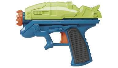

Well, my Nerf Super Soaker Flash Blast arrived today so I figured, why not try it out. Being the only new pressurized model, while only pistol-sized, I did have some hopes for it. As expected, the top of the blaster is the pump and is pulled back much like some older Nerf Guns to draw water into the pump. Pulling the trigger releases things and the internal spring compresses the pump making the shot. The reservoir isn't huge, being at 122mL (~4oz) (the box says 110mL), but that's still more than the Nerf Super Soaker Electrostorm (85mL) and the old Super Soaker 20 (115mL).
The pump volume/firing chamber volume, though, is a whopping 6mL. If that wasn't bad enough, the stream produced even suffers from drop-off, losing performance through the shot. Perhaps the first 3 or so mLs get out at full speed, then it tapers off to a dribble.
On the "bright" side, the blaster does work in "slam-fire" mode. Since this thing is so small and the pump volume so low, there is no notable lag when pumping.
However, another problem with this blaster's design shows up when going for refill. The cap on the reservoir has no hole and there seems to be no other inlet for air. Thus, as water is being drawn out of the reservoir, its internal pressure is dropping versus the outside. Thankfully (???), the reservoir is small that it does not end up collapsing due to the negative pressure, but this is definitely a design oversight.
The blaster looks nice and the grip is very comfortable, but I don't think many here will find much use in this blaster. Perhaps as a back-up for your back-up's back-up? :goofy: Though I'd argue that running is probably a better option.

Post by isoaker » Fri Jan 18, 2013 4:36 pm
Buffdaddy wrote:Essentially, this would be better off shooting Nerf darts than water. Got it.
Y'know, that pretty much sums up what this blaster is. It really seems like they took a Nerf gun, shoved a syringe-type piston into the barrel, gave it a smaller nozzle and a water reservoir and called it a day. If they just used the same springs as used for Nerf darts, well, those darts weigh ~1g while this 6mL of water weighs 6g (or roughly worth 6 darts). The poor spring really didn't stand a chance...

Thinking back, the Flash Blast really felt familiar to a dart gun I've used before and I finally remembered which - the Ruff Stuff ThunderStrike by Buzz Bee Toys Inc (from 2009).
Ruff Stuff Thunderstrike
I have one of those somewhere - makes noise when loading and shooting and actually shot its dart fairly decently. It's almost like Hasbro just ended up using the same mechanism for their Flash Blast - fine for a foam dart, but lousy for a water blaster.

Pictures of the Nerf Super Soaker Flash Blast now posted. Review to come after I finish the Nerf Super Soaker X-Treme Hydro Pack's review.
Re: Hands-On: Nerf Super Soaker Flash Blast @ iSoaker.com
Post by isoaker » Thu Jan 24, 2013 9:53 am
While others have had fun reviewing more meaningful blasters, I get the honor of pushing up another 2013 Nerf Super Soaker review. :goofy:
Nerf Super Soaker Flash Blast review posted.
Enjoy it for what it's worth! :goofy:
