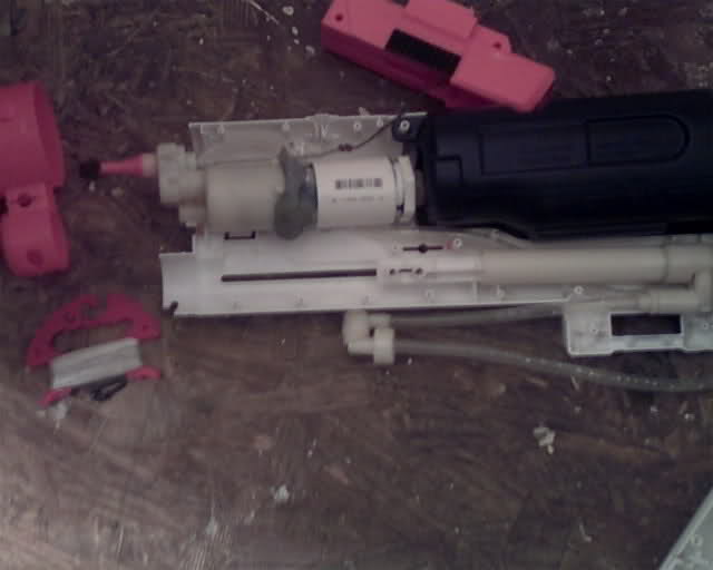

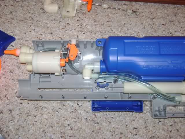

First, open up the Shot Blast. This is difficult to do. You have to unscrew it, snap off the outer shell, and then take off the inner shell. I forgot to take pictures of the stock internals, so here's a pic, courtesy of Nerf Mods & Reviews.
Shot Blast Stock Internals

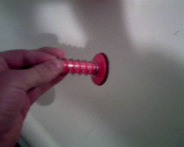

Unscrew the back of the pressure chamber (the dinky little tank that looks kind of like an Airtech tank). You will find a plunger and spring inside. Take this out. Because of the seal, you may have to open the pull valve to get it out.
Shotblast Plunger and Spring

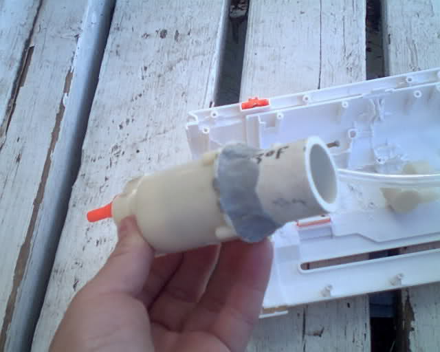

Epoxy a piece of 1" PVC pipe into the PC tank. I used epoxy putty. Be sure to stuff the putty in good so that it doesn't leak.
Shot Blast PC and 1" Pipe

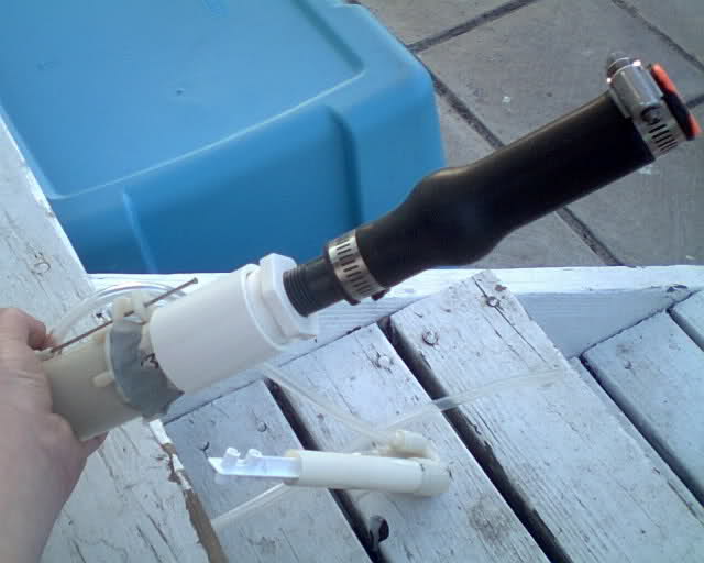

Attach a pressure chamber to the piece of PVC. I used a rubber bladder from a HydroBlitz. You can use anything you want as a pressure chamber - even the stock one, although this would give it worse performance than it was stock. It might be an easier mod to attatch an air-pressure chamber, using a bottle or large-diameter PVC pipe. Here's my PC:
New HydroBlitz Bladder PC

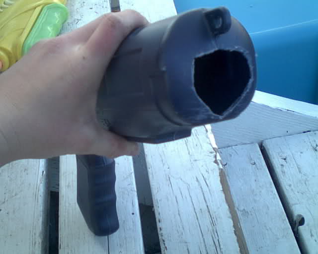

Now take out the water reservoir and put a good sized hole in the front of it. This is going to be the PC casing for my rubber bladder. Also, get the reservoir cap and tether out.
Stock Reservoir with Hole

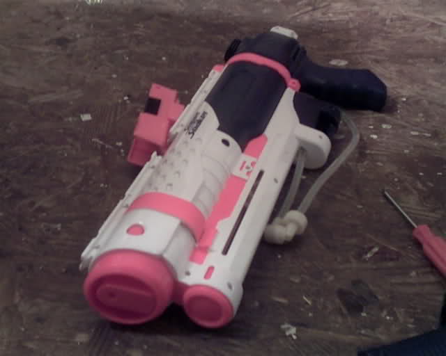

Snap on Outer Shell
...and then screw it all together, and put the pump grip back on. Also, clip the Strikefire slide onto the tactical rail if you're using my trigger system method.

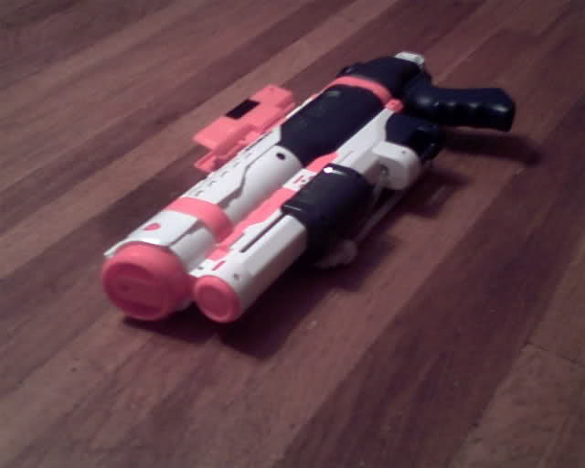

Finished!
You're done! Now hopefully it works... The first time I did this, there was a leak, and I had to open it back up and apply more epoxy putty. The second time, it worked for a while, and then another leak appeared - apparently the epoxy wasn't completely dry. Now I applied more epoxy, and I'm going to wait several days to be sure it's dry. So be sure you stuff the epoxy in really good, and wait several days before using it. The top-mounted trigger system works great.
