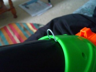

[edit] Method 1

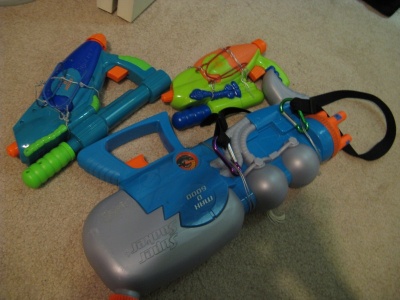

This method is one of the simplest, yet one of the most effective. It involves attaching the metal wires to the outside of a blaster's casing, reducing the liklihood of irreversible damage or changes to the blaster.
[edit] Materials Required
Metal packaging wire (as much as required)
[edit] Assembly

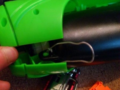

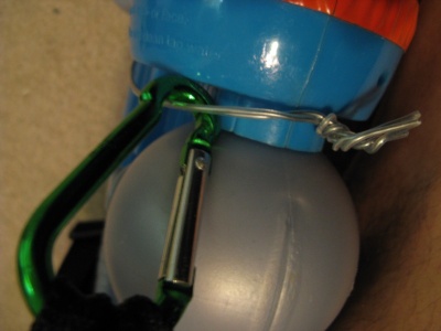

Most blasters do not have hooks for the new strap to go into, so that's where the thin wires come into place. As depicted, they can be twisted together to create hooks which the straps can link to. If the blaster being used already has hooks, it's a good idea to connect them to a short loop of cable tie, then connecting the cable tie to the metal hook. This slows down deterioration of the stock plastic hooks. If the hooks break, you can, of course, create your own using the thin wire method.
Max-D 6000 Strap Hooks Close-up
[edit] Advantages
Mod is reversible
There is no damage caused to the blaster (aside from possible minor cosmetic damage)
Doesn't require blaster disassembly
Very Durable and secure when good spots for the wire are used.
[edit] Disadvantages
Not as aesthetically pleasing as other methods
Some blasters do not offer good spots for the wire
Generally, all of the wire must be removed before opening the blaster for repairs/maintenance
Can require a lot of wire (depending on blaster)
Wire ends must be adjusted appropriately to minimize the risk of sharp points

This method involves attaching the metal wires to load-bearing internal structures of the blaster (e.g. PC mounts) through existing gaps in the casing. It is especially useful for those whou don't have much packaging wire available and/or those who want a less intrusive strap mount.
Screwdriver(s) (for blaster disassembly)
[edit] Assembly
Locate suitable mounting point(s) for the strap (e.g. a load bearing screw/component such as a PC mounting peg).
Disassemble the blaster to a point at which you can easily access and work in the selected location(s).
Attach wire(s) to selected mounting point(s), and twist the wire ends together, to secure.
Conceal the twisted ends somewhere inside the body of the blaster.
Re-assemble the blaster.

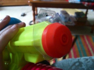

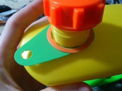

[edit] Method 4
This method involves using plastic sheets to create thin yet durable strap mounting points on a blaster. This method is especially useful for attaching a sling mounting point to the neck of a blaster's reservoir and/or to the front of a blaster with a clip-on nozzle cover and for those who haven't got access to packaging wire.
1x Rigid plastic sheet (anything you can get your hands on [old plastic ringbinder, thicker food packaging, etc.])
1x Scissors/knife (sharp and strong enough to cut through plastic)
1x Drill bit
[edit] Assembly
Cut the plastic sheet it into a rectangle (large enough to fit around the filler neck of the reservoir / behind the nozzle cover).
If you are using a very thin piece of plastic (especially if it's less than 0.5mm in thickness, like the plastic from a food package) make the strip long enough to fold over and double up.
Mark out a hole at one end of the plastic (at the opposite end to the fold if you've doubled it up) large enough to fit over the filler neck of the reservoir / behind the nozzle cover.
Use the drill bit to make a small hole in the centre of the marked circle, to give you somewhere to insert the scissors/knife.
Cut out the circle, but try to leave some material to fit between the threads (if using on reservoir filler neck).
Drill a hole in the opposite end of the plastic (the side closest to the fold if you've doubled it up) large enough for your sling clip.
Cut the corners off the plastic to make it less sharp and to look nice!

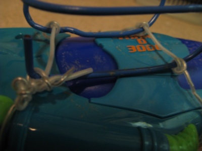

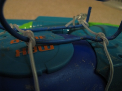

Cut the coathanger to an appropriate length and bend it to create the shape as pictured using pliers to do this (this will be the belt clip itself).
Trim and bend coathanger wire as depicted. - Wrap thin wire to coathanger wire twice as pictured; make a knot around each connection with the coathanger wire for added security.
Tighten the knots as best as you can. This is tricky and may result in sore fingers.
Wrap metal wire across blaster and secure it tightly with a twist-up.
Repeat; connect other thin wire to the two points of the coathanger wire in the same manner.
The other method of attaching the coathanger wire involves duct tape. However, duct tape is not as durable and leaves behind a LOT of residue if you need to remove the clip. However, it is useful for non-durable items like water balloon carrying cans/cups and water bottles.
