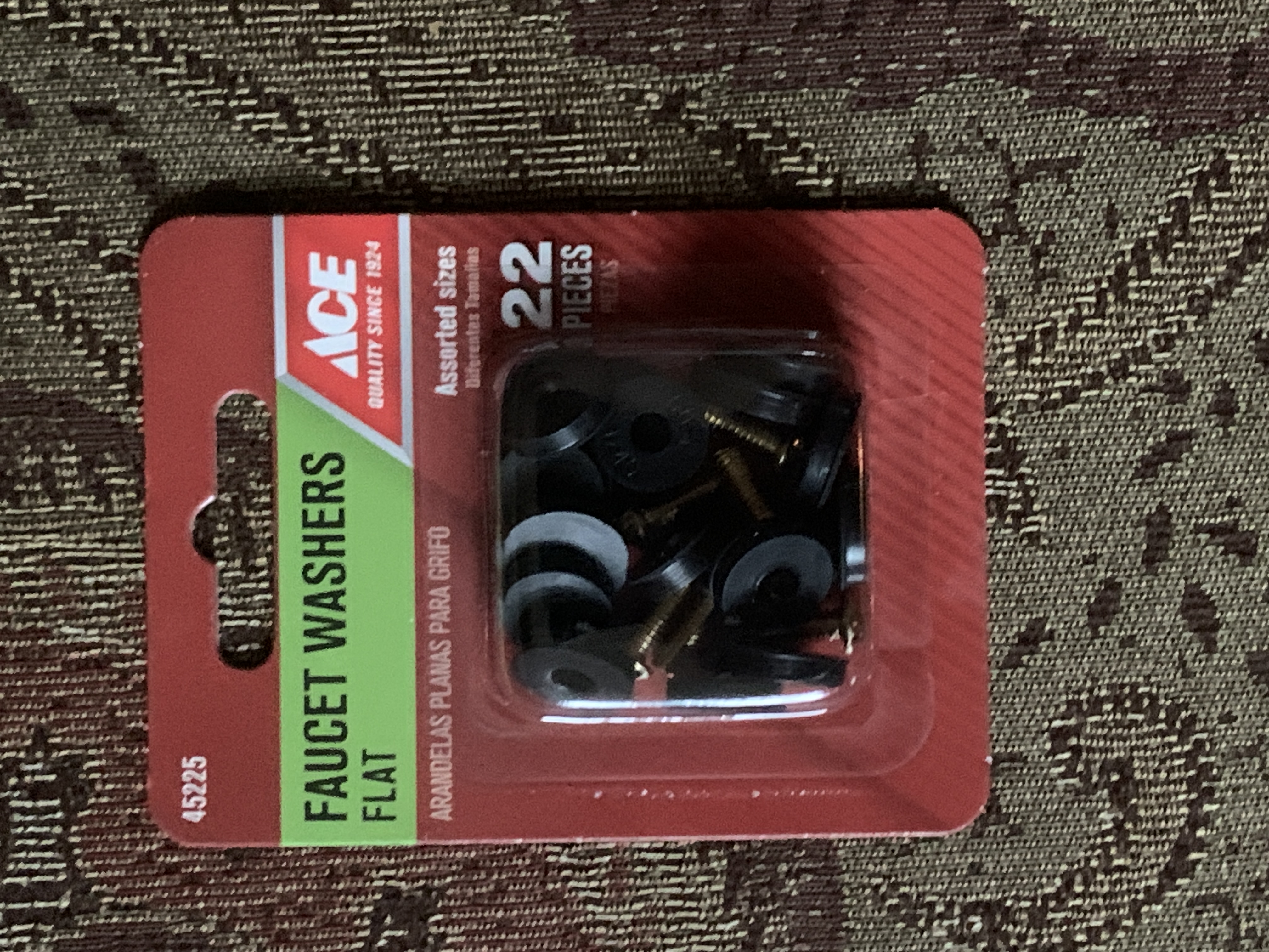

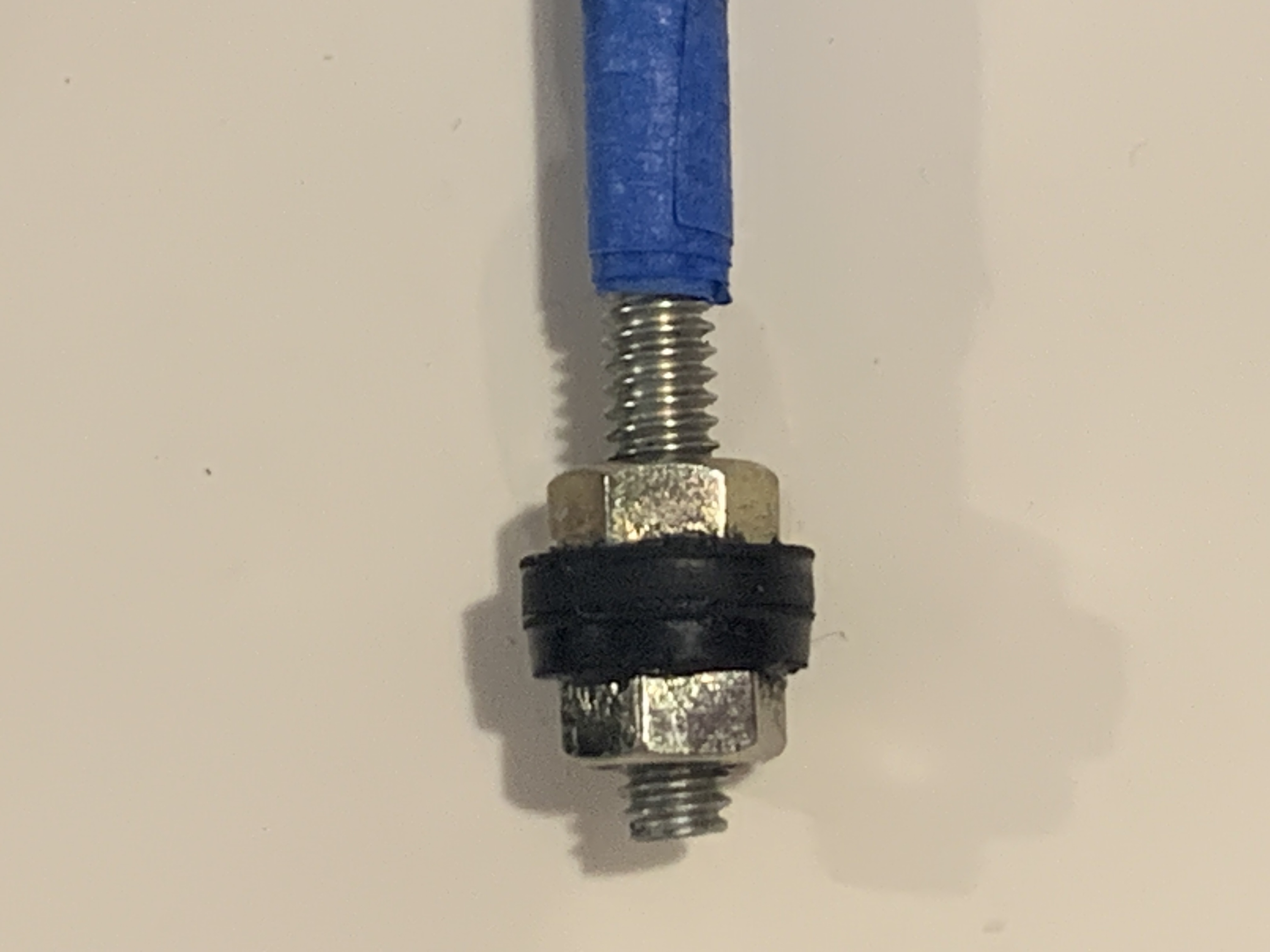

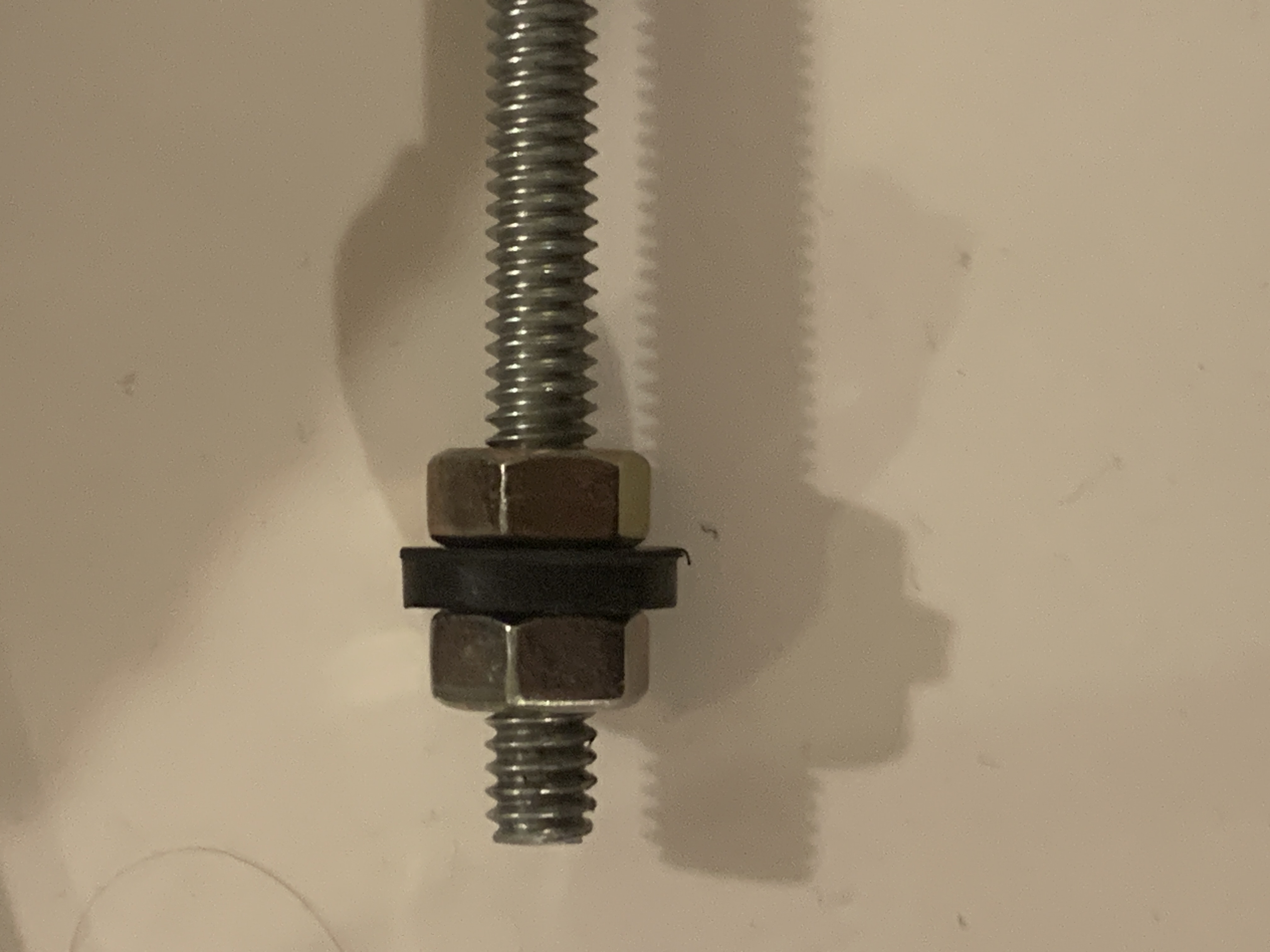

hi Ben sorry i didn't reply sooner. Ive been busy with stuff and I have been busy actually making a prototype of this pump which i finished today. i found out that 1/4" threaded rod just as you suggested was perfect so i thank you for that. 1/4" nuts also don't interfere with 1/2" ID PVC pipe so that was quite a relief. for the seal i used assorted rubber washers from a hardware store i went to. the only thing i don't like about the rubber is that its on the harder side. Ive kinda tested its seal and it is air tight if it will pump water im not sure Ive filled some 1/2" PVC pipe with water and it pumped it all out without leaking. however i do understand your point in hex nuts not sealing, i believe and i might not be right here but Teflon tape could be able help with that problem. or might not i haven't tried it yet. i have some pictures of the completed pump i haven't tested it with my APH yet due to the threads not being covered yet. but i hope i will be able to improve with the next design. if anyone wants to know the price for this 24" pump was in total-6.58 USD which im not sure if that's expensive or not. anyways here's some pictures of the completed pump let me know anything you would change about my layout.
- washer set i used

- bolts and seal

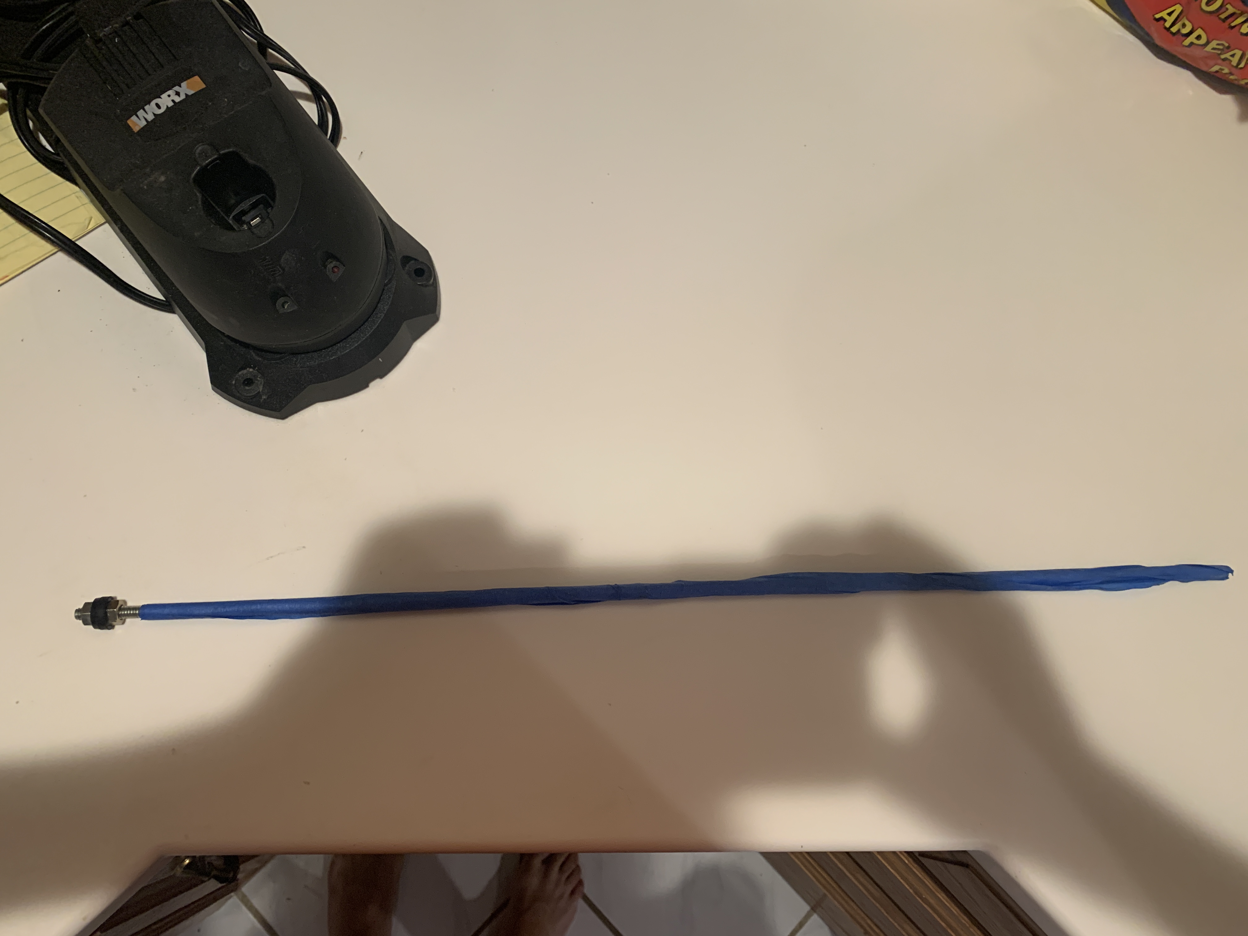

quick update Ive tested this pump on my APH and it worked 100% without leaking, i just had to tweak the design a little. all i did was add another rubber washer and tightened the hex nuts until i couldn't anymore and taped the threaded rod so it does not damage internals. i also have a more accurate calculation about the pumps price, its more like 3 dollars for the completed pump once completed. for all the total parts its 6.58. overall i am pretty happy of how this came out, and i was not expecting for it to work the first time, i will definitely make more of these metal pumps for future projects. here's some photos of the completed pump.
