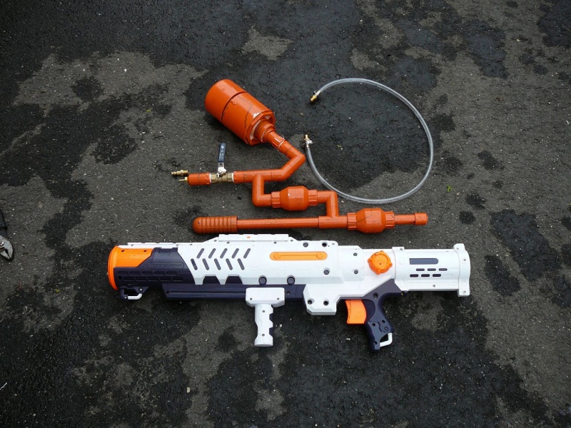

An Air Pressure Homemade (APH), can refer to any homemade water blaster which utilizes air pressure to power a stream of water. However, it is most commonly used to refer to traditional separate air chamber designs that use vertical water vessels, based on the XP Super Soaker designs. This design is very popular, combining high performance and design flexibility with low cost materials and simple construction. It is recommended for enthusiasts who have some experience modifying or repairing water blasters. Properly constructed, an APH can prove to be a powerful and effective addition to a water warfare arsenal, and if properly built and used, will outperform any manufactured water blaster.

The first recorded construction of an APH was Pepper's water gun. Built in 2003, Pepper's water gun featured several innovative design elements which later became standard in common APH-design. These included separate Pressure Chambers, an on-board reservoir, and interchangeable nozzles. This water gun also featured a homemade pump and pump-seal. In 2004, a consolidated version of this gun appeared in Ben's APH-design. This design is credited with popularizing the APH model and paving the way for a slew of homemade APH-designs to follow.

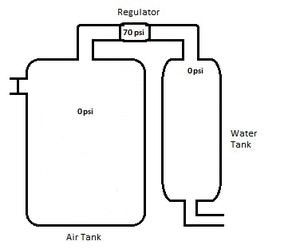

CAPH Firing Steps
The Constant Air Pressure Homemade (CAPH) operates on the principle of air-pressure, just like the APH. However, unlike the APH, the CAPH uses a regulator to maintain this air pressure to keep the pressure in the water chamber constant. First the smaller pressure chamber is, almost completely, filled with water. Then the larger pressure chamber is filled with air and pressurised to around 100psi. The regulator is set to around 70psi, and transfers pressurised air, from the larger pressure chamber, to pressurise the water in the second chamber to 70psi. Whilst firing, the water level decreases and pressure in the second chamber reduces. The regulator transfers more pressurised air into the second chamber to maintain 70psi pressure on the water. Once the pressure in the first chamber falls below 70psi, the regulator stays open and the two chambers decrease in pressure together.
[edit] Advantages
The CAPH design retains many of the advantages of the standard APH, with the addition of constant pressure. In fact a small and lightweight, yet practical CAPH system would be regarded by many as the ultimate water blaster.
[edit] Disadvantages
A CAPH is usually quite large and heavy, and can be very expensive to construct. Also, unless there is some form of seperation between water and air, the CAPH cannot be fired upside down, or at some angles unless fitted into a backpack system.

The CAPH is composed of three main sections. These are; the larger primary air PC, the smaller water PC, and the regulator between the two. Like the APH the orientation and positioning of any of these sections is flexible, and the oulet in the smaller water pressure chamber must be located at the "bottom" of the chamber, unless a there is a separation between the air and water in this chamber. If there is a separation then it is possible to position the PC, the outlet valve and the nozzle inline with each other to make the flow more laminar.
