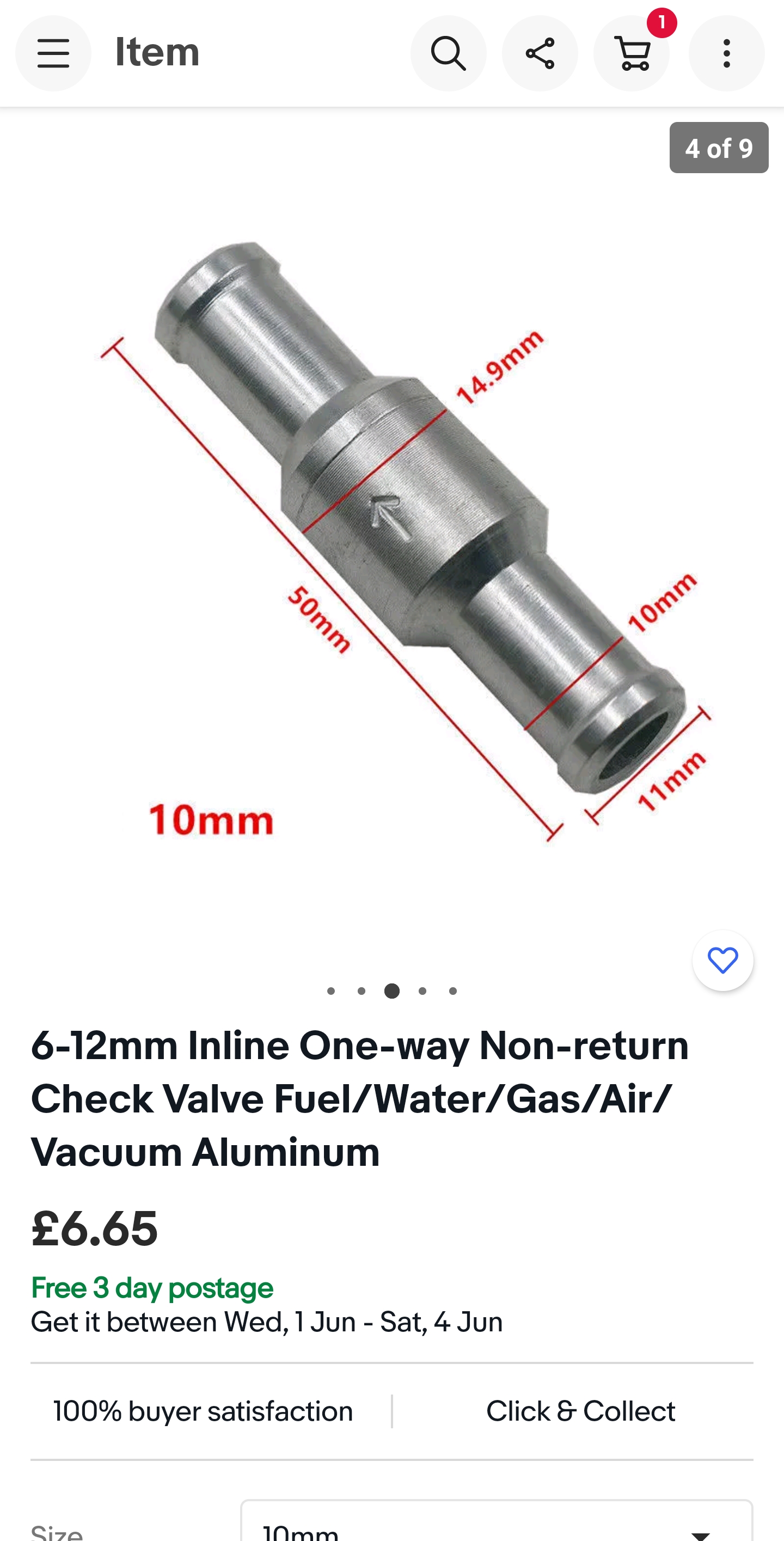

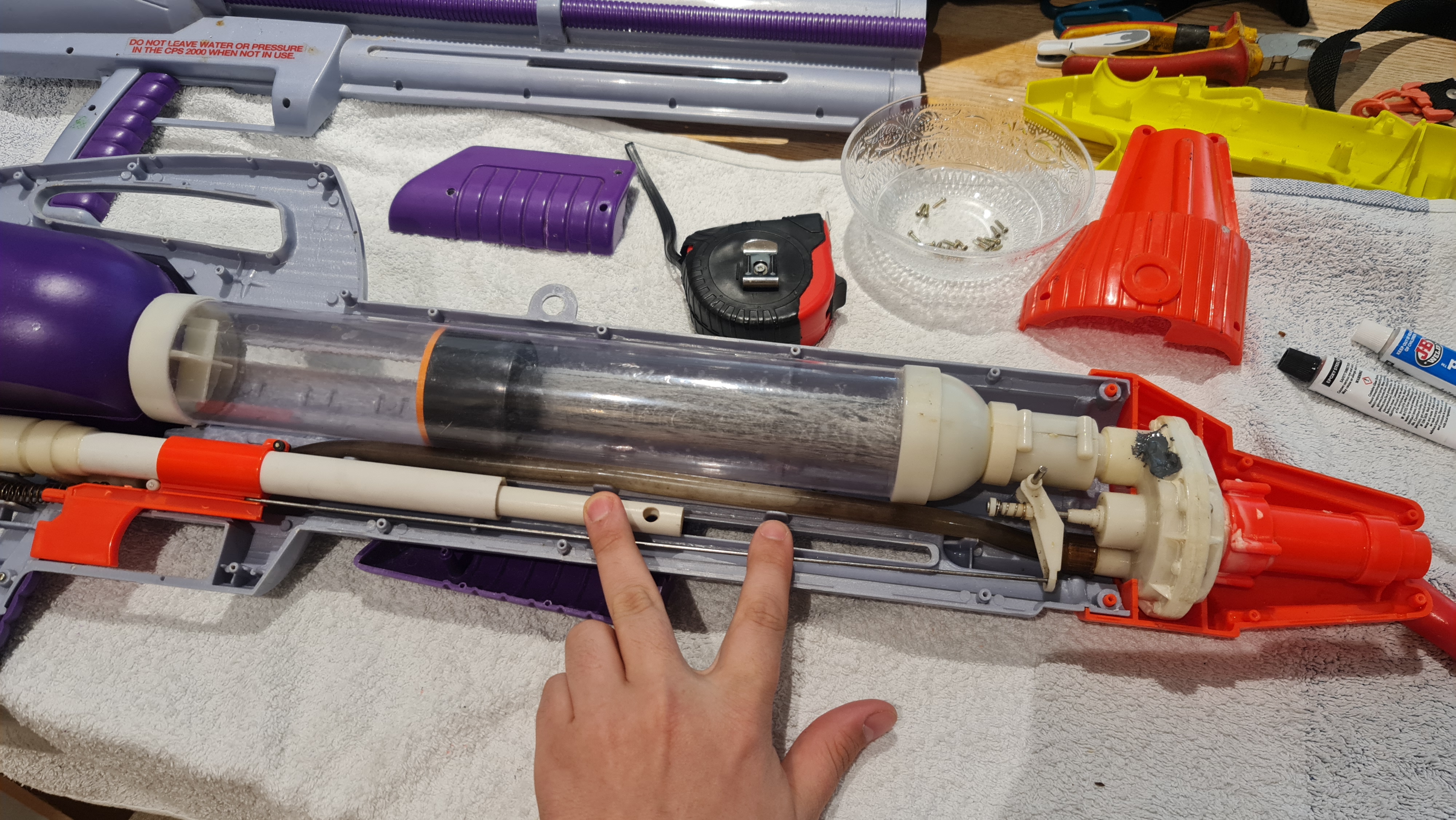

Any tips on where I can get a check valve to fit in the housing? Finding one small enough is difficult. Iv found one on ebay that's 14.9mm thick, if you look at the image iv added I believe I can fit it in between my fingers, there's a 15mm gap between pump arm and bladder tube. Iv also attached photo of valve that's the smallest width I could find with a 10mm hole. The tubing is about 11mm on outside so il wedge this in. Will probably take a few more pumps to pump up as the diameter hole will be slightly thinner than the tubing but I think that's a minor problem.

You've probably already checked this, but I'd see if there's more space closer to the pump outlet side on the left. I'd guess there's a spot with a bit more space, or a spot where you can cut away at the case a bit to get enough space.
As for finding other check valves, I assume that you're in the UK. I don't know much about where to buy parts like these small check valves in the UK. The small valves I was thinking about using on McMaster-Carr are 12.7 mm wide, so those'll work. But McMaster-Carr won't ship outside of the US.
You might want to look into valves from Clippard like this one. It is 14.3 mm wide. This valve doesn't have barbed fittings, and I suspect the flow will be constricted once you put barbed fittings on. You might want to look at what else Clippard has. Also, you can buy direct from Clippard but it'll be really expensive. I'd recommend taking a look at their distributors to find a local one as that'll be a lot cheaper.
