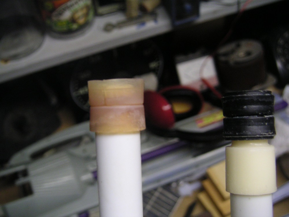

Well the pump I am struggling with is a little different than the one in soakinader's picture. Here's a picture of it (on the left) next to a pump from what I believe to be a 2100. You should be able to see the crack in it.
- Sorry if it's a little blurry...

Looks like an XP 70 pump on the right, I still have the pump from mine.

How tight is the seal now? If it isn't 100%, you should be able to put some teflon tape around the cracked (ripped?) part, and some tubing behind the second collar.

Haha, that's okay. I actually came up with a new plan; the rubber seal is actually screwed onto the end of the pump. What I'm going to try to do is unscrew it and flip it around, because the other half of it is not cracked/teared. The only thing is, the screw is inside the hollow pump, and I don't have any phillips screwdrivers long enough to reach it. I'm going to look for one tomorrow when I go to the gym.
